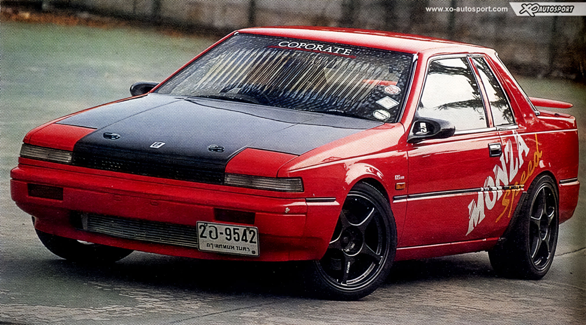

Nissan Gazelle - Retro Hybrid Breed
In the 2000s, “cross-breed” engine swaps were incredibly popular. This was perhaps due to insufficient engine power for some cars, but nothing compares to the thrill of performance driven by speed enthusiasts, regardless of the car's condition. This particular car, an older 1980s model, isn't just any old, dilapidated vehicle; its extraordinary feature lies in its “rotary engine”, delivering exhilarating acceleration and a breathtaking sound. The engine's tone is sweet, similar to a six-cylinder, but far more aggressive, especially at idle, where it “sobs…!” It's a modified “3-rotor” engine, but with just a few modifications that left our team speechless! Want to know more? Keep reading!
The body is a 1985 Nissan GAZELLE, chassis code S12, which was sold for scrap metal, while the original CA-18 DET engine was disposed of as “scrap metal.”
Many readers may not be familiar with the “Gazelle” because it's a classic model from the era when the last rear-wheel drive Corolla KE-70 was still relatively new and modern-looking. Going into its history would take up too much space, so let's just say it's part of the S12 family, produced around 1985. While the Silvia had a Liftback rear end, the Nissan Gazelle was a coupe, similar to the Corolla Liftback and the Trueno AE86. Its original engine was the CA-18 Det, producing around 145 horsepower. Not many were imported into Thailand back then; most cars of that era were the Supra with the pop-up headlights and the 7-M Turbo engine.
This car belonged to Mana Pornsiricherd (at that time, he was considered a successful and quite famous young racer). A chip off the old block, heir to “Nang Modify”, a prominent figure in motorcycle modification, but he didn't pursue motorcycle racing, opting instead for go-karts and cars (though his father was worried and didn't want him to race motorcycles). This GAZELLE was originally owned by his father's friend. When Mana saw it, he liked it and asked his father to buy it for him. He then had the engine swapped to a Rotary 13B Turbo at Monza Garage, Ladprao 87. Since then, the car has been continuously maintained by Monza Garage.

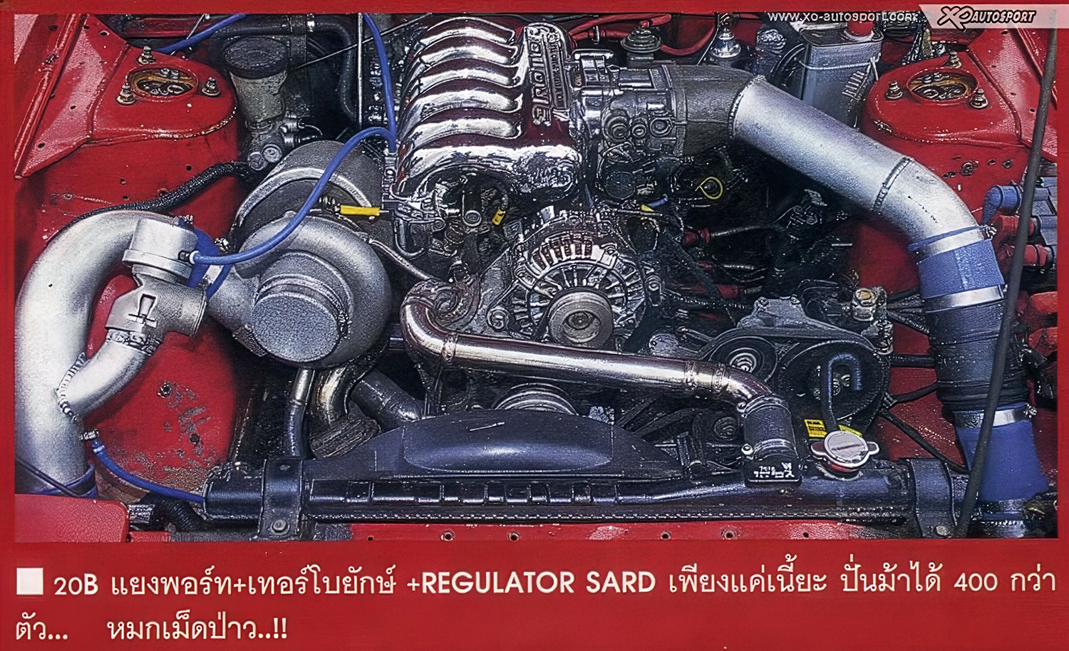

A ported 20B engine + a giant turbocharger + a SARD regulator – that's all it takes to produce over 400 horsepower… Is this a secret?!

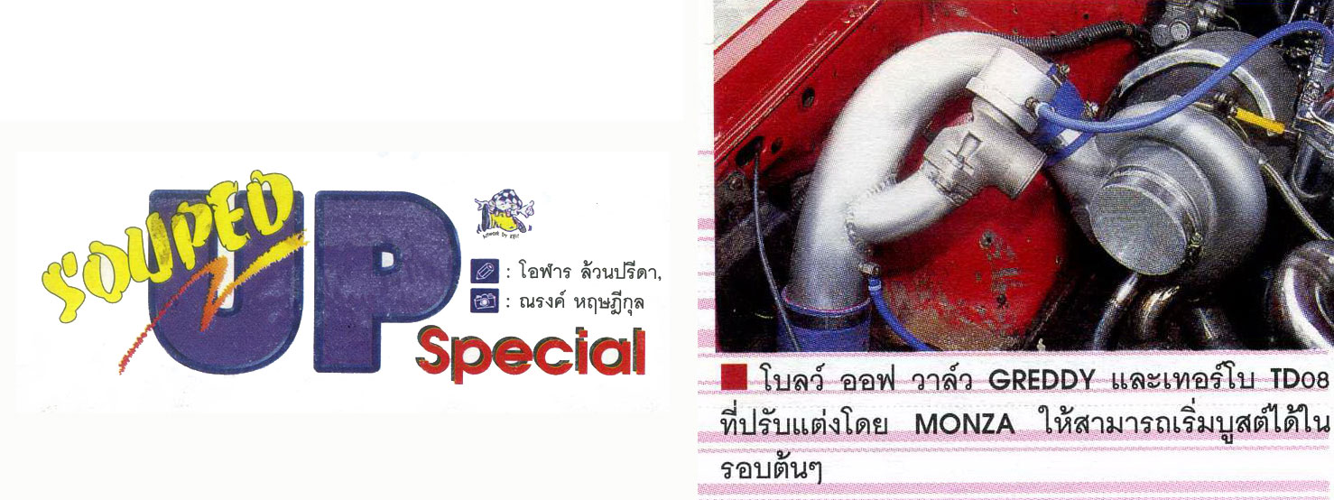

The heart of this powertrain is the TD-08 turbocharger, but it's been modified for maximum performance according to “Tee Monza's” formula.
Outwardly, it looks like an ordinary turbocharger, but inside, it's “hidden gems.” The turbocharger impeller has been replaced with one from a large truck, approximately 2-3 mm larger than standard, similar in size to Greddy's T88. The turbo housing has been modified with re-welded, smaller ports to channel exhaust gases faster into the turbine, significantly reducing turbo lag. The intercooler has been replaced with an HKS unit to cool the intake air before it enters the combustion chamber, with intercooler piping done by Fighter. A Greddy blow-off valve controls excess intake air flow during throttle release, and the HKS GT wastegate, which regulates boost pressure to the set level, is also included.

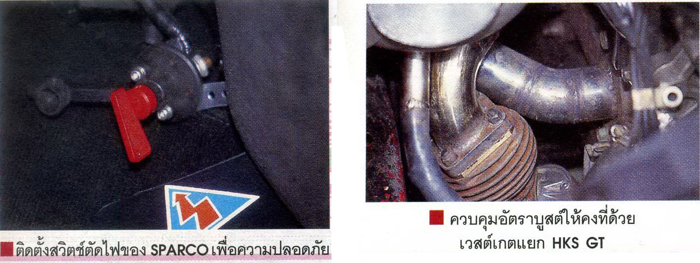

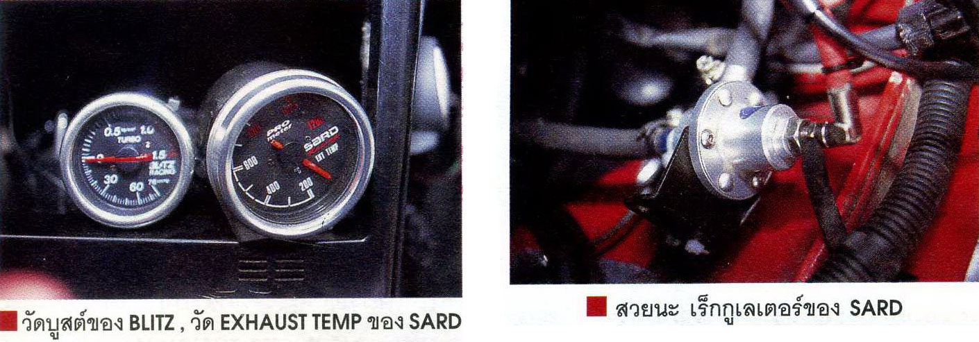

Left: Install a SPARCO circuit breaker for safety. / Right: Keep the boost rate constant. Wastegate HKS GT Split.
Left: BLITZ boost gauge, SARD exhaust temperature gauge. / Right: That's a nice SARD regulator.

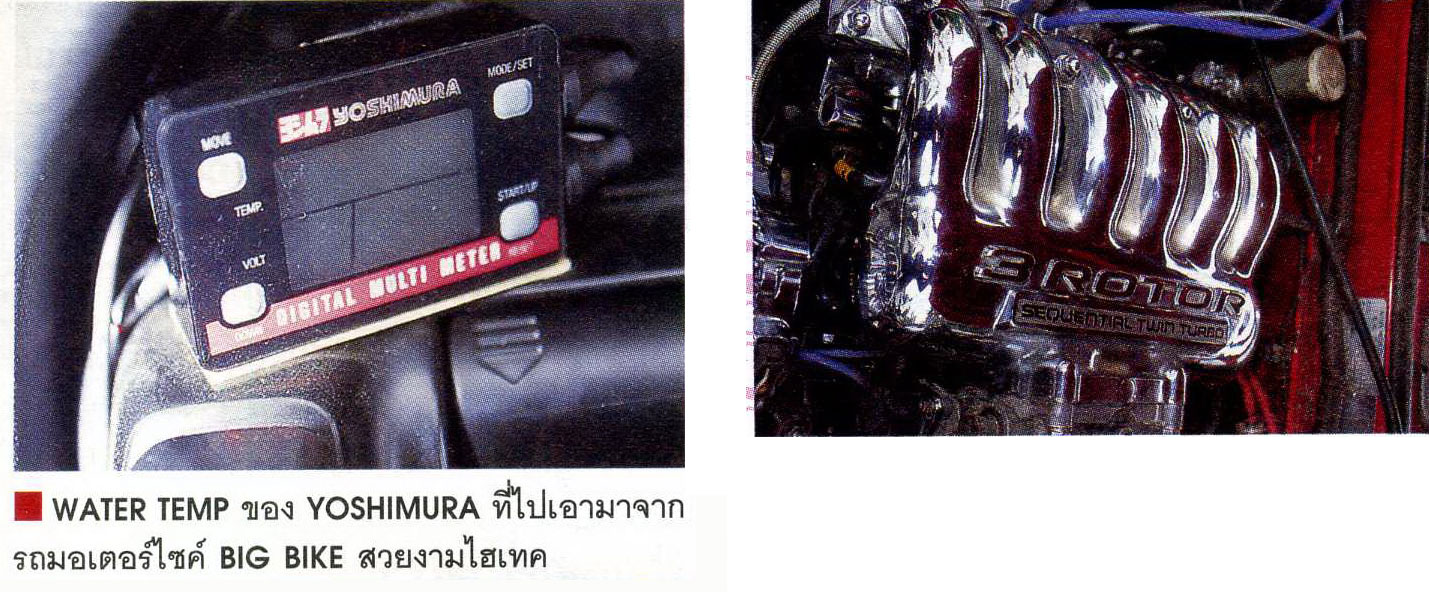

Left: Yoshimura's water temperature reading was taken from a beautiful, high-tech big bike.
Right: The GREDDY blow-off valve and MONZA-tuned TD08 turbocharger allow for boost to start at low RPM's.

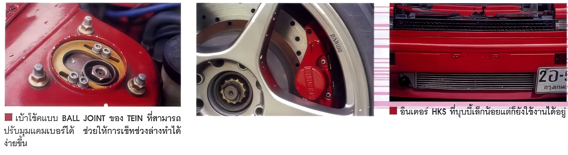

Left: TEIN's ball joint shock mounts, which allow for adjustable camber angles, make suspension tuning easier. / Right: The HKS intercooler is slightly dented but still usable.

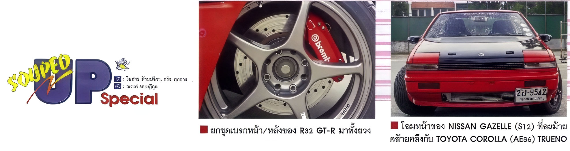

Left: The entire front and rear brake assembly from an R32 GT-R is included. / Right: The appearance of the NISSAN GAZELLE (S12) bears a striking resemblance to the TOYOTA COROLLA (AE86) TRUENO.

Suspecting that front suspension parts would be hard to find, Monza Garage decided to do a complete conversion. They replaced the front axle and steering rack with those from a Nissan 200SX. As for the rear suspension, which originally used a solid axle with shock absorbers, they replaced it with an R32 rear axle assembly, providing an independent rear suspension system. Furthermore, they enhanced performance with gas-filled coilover struts and Tein springs, which offer 21 levels of stiffness adjustment at the top of the shock absorbers. With this setup, you can be confident that you won't need to ease off the accelerator when cornering.

No workshop that modifies a car would neglect the brakes. Since this GAZELLE already had its suspension completely replaced, they opted for a brake kit from the same family. Because the differential and rear brakes were from an R32, they also installed the front brake discs and calipers from a Skyline R32. Finished off with Endless brake pads. Now, no more needing to rely on lampposts for sudden stops!

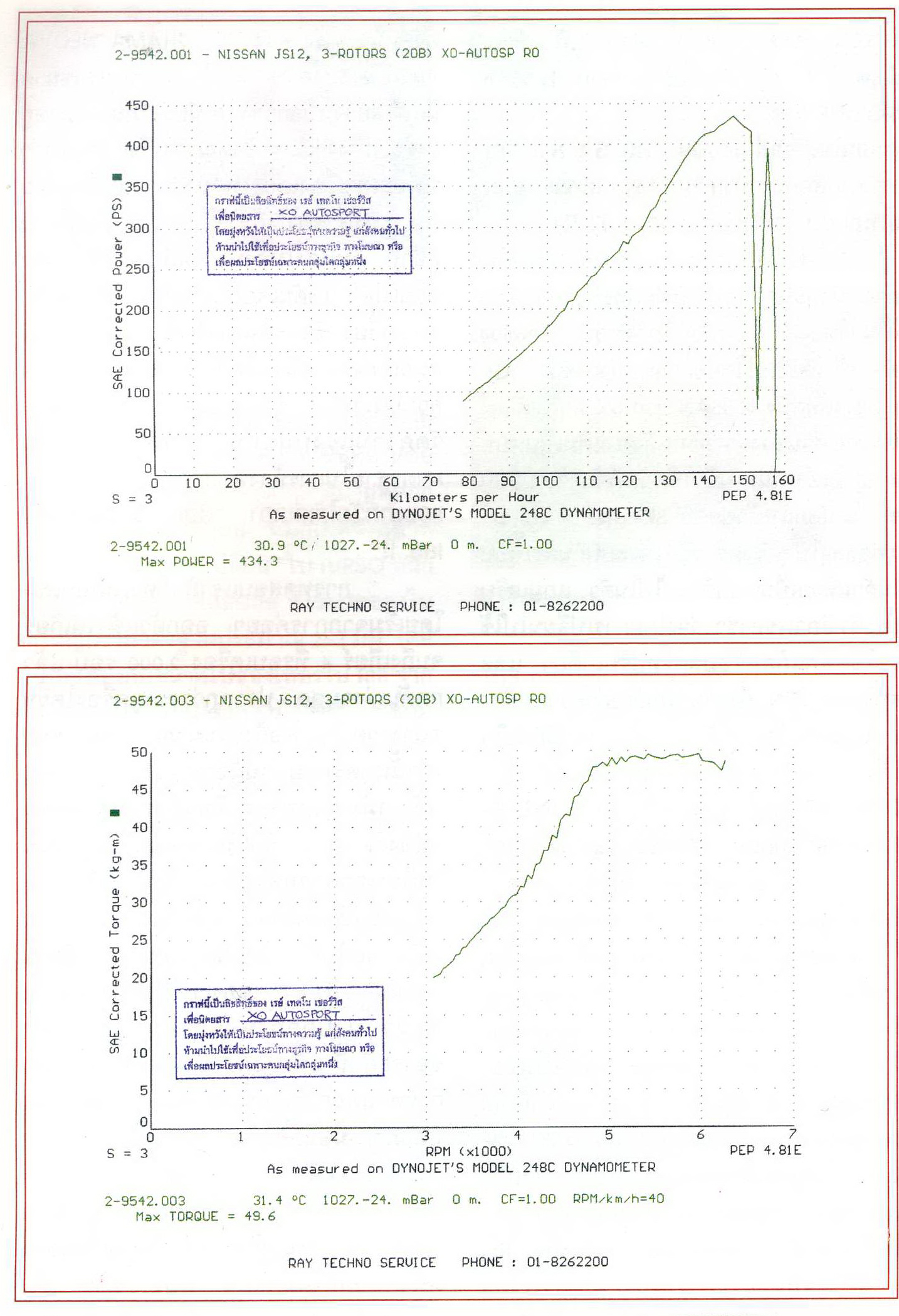

The measured horsepower was so shocking.. it was unbelievable!
The horsepower test was done the same way, starting with a slow acceleration to 4th gear at 2,000 rpm, then pressing the accelerator all the way down. The engine revved up rapidly, and around 3,000 rpm, it surged to its maximum, causing the ECU to cut out! The sound was exactly like a slipping clutch – the engine revving up like “revving in place,” indicating extraordinary power. To be sure, we tried again, and the result was the same. We suspected a “slipping clutch,” but when we saw the graph, the team was shocked! The sound that sounded like a slipping clutch was actually the engine running without the air conditioning and power steering pump to dampen it, allowing the engine to rev more smoothly. Combined with the powerful and rapid air compression from the giant turbocharger at a boost rate of only 0.8 bar, it can generate “434.3 PS” of horsepower. The horsepower curve starts at a speed of 78 kilometers per hour at approximately 2,000 rpm in 4th gear and slopes steeply at a 45-degree angle throughout, ending at 152 kilometers per hour before dropping straight down because the stock ECU cuts the engine speed to prevent damage. Notice that it can reach 152 kilometers per hour even in 4th gear, which is due to the aggressive gear ratio. The top speed is lower, but the acceleration is better. The measured torque is 49.6 kg-m at 5,900 rpm. Observing the torque graph, you can see that in the 3,000-4,800 rpm range, it has a steep slope similar to the horsepower graph, and then in the 4,800-6,300 rpm range, it is a straight line. This shows the turbocharger's power beginning to manifest at low rpm and being able to generate power continuously.
